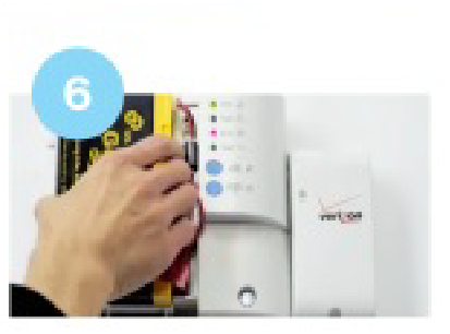

Gently disengage the retaining clips that hold the battery in place and remove the battery.Disconnect the battery clips from the old battery and set the battery aside for proper disposal. If you are not installing a new battery, proceed to Step 8. Save the red and black cable for future use.

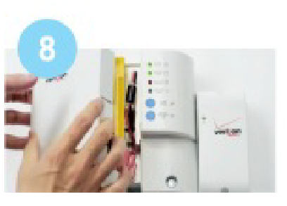

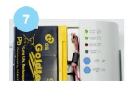

Remove the plastic covers on the black and red terminals of your new battery. Connect the battery clips to the corresponding black (- negative) and red (+ positive) terminals on the new battery.Slide the new battery into the battery compartment , securing it underneath the retaining clips.
Insert the plug connector back into position. If the battery is installed correctly, you'll hear a beep and the battery power and system status lights will be solid green.Replace the battery cover and plug the BBU back into your wall outlet.
