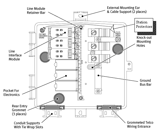

Testing your connection with the Network Interface Device (NID)
If you’re having an issue with your phone, you can quickly determine if the problem is related to your inside or outside wiring by testing your NID. To get started, you’ll need a insulated screwdriver, a telephone to connect to the NID, a flashlight, and a copy of this procedure.
Note: Although the lines are grounded, do not open the NID or test the lines during rain, a thunderstorm, other hazardous weather conditions, or if there is water pooled on the ground near the NID.
Step One – Opening the NID
Step Two – Locating the phone connection
Step Three – Testing your connection
If there is no dial tone
The problem is with your outside wiring. Unplug the phone, plug in the voice line, close the cover to the NID, and replace the screw.
