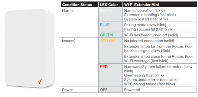

| Too Far | Unified LED Yellow Slow blink | Placement of the Extender relative to the router is Too Far. Customer should move the extender closer to the router for the Optimal Performance |
| Optimal | Unified LED White Solid | Placement of the Extender relative to the router is Optimal for good Wi-Fi throughput. No action needed. White LED remains solid lit while extender is in an optimal position |
| Too close | Unified LED Yellow Fast blink | Placement of the Extender relative to the router is Too Close. Customer should move the Extender further away from the router for the Optimal Performance. |

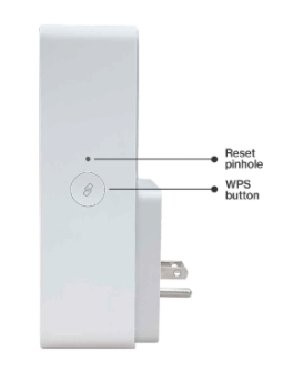

Pressing and holding the reset button located on the side of the Wi-Fi Extender Mini will restore the extender to the factory default settings. Use the pointed end of a paperclip to press and hold the button for 3-5 seconds.
