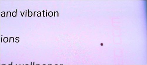

  1. To identify if your device has water damage, check for:
    • corrosion, discoloration or oxidation on the charging port or SIM tray.
    • moisture under the display screen.
    • Liquid Detection Indicator (LDI) / Liquid Contact Indicator (LCI) activation.

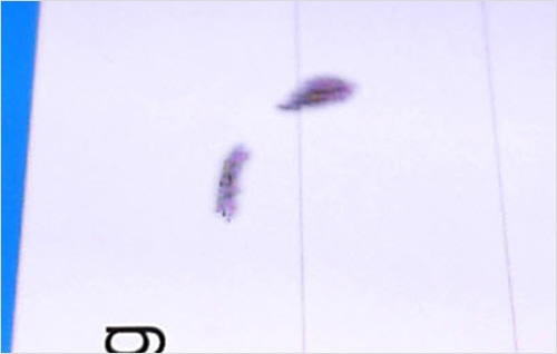

      The Liquid Damage Indicator (LDI) is located inside the SIM tray slot, directly to the left of the SIM PIN hole. It's visible by looking inside the SIM tray with the ejection pin to the right while the tray is removed from the device.
      Samsung uses a white field to indicate a device that has had no liquid contact. When the indicator comes in contact with liquid, the paper becomes pink.
      LDI
      Samsung LDI

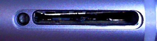

Damaged Ports

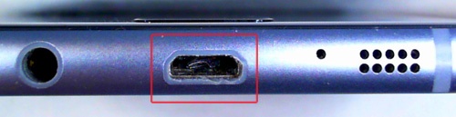

  1. View the following ports using a bright light and a magnifier if possible:
    • USB / Charging: Examples of charging port damage include but are not limited to:
      • port is loose or wiggles.
      • bent ports.
      • corrosion.

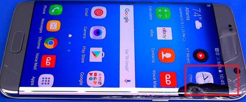

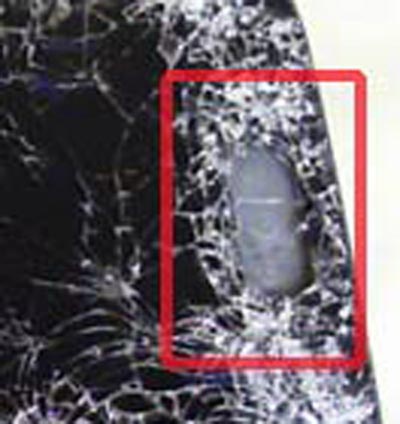

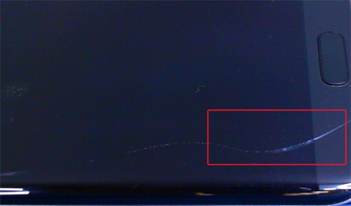

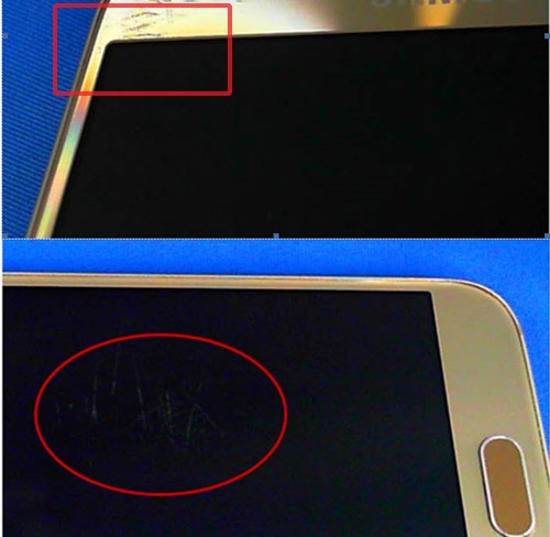

Display Issues or Damaged Buttons / Camera
Examples of screen damage / button issues include but are not limited to:

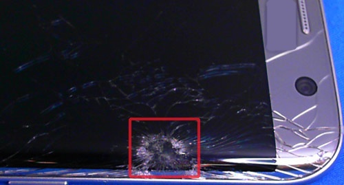

  • Display
    : Examples of display issues include but are not limited to solid line(s) present across the screen, bleeding display, punctures, cracks or excessive scratches.

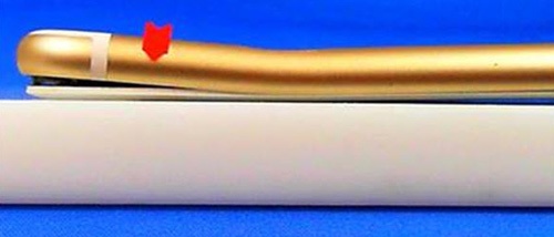

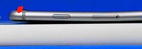

  • Warping
    : Device or screen won't lay flat.
