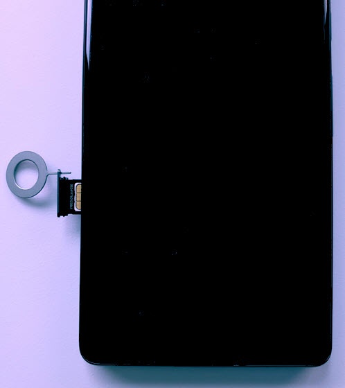

  1. From the bottom-left edge of the device (display facing up), insert the SIM removal tool into the hole then push in until the tray ejects.
    Insert SIM removal tool
  2. Do one of the following:
    • To insert the SIM card, use the notch in the card as a guide then insert the SIM card into the tray with the gold contacts facing up.
    • To remove the SIM card, lift the card from the tray.
  3. Carefully reposition the tray into the slot then gently push it back into the phone.
