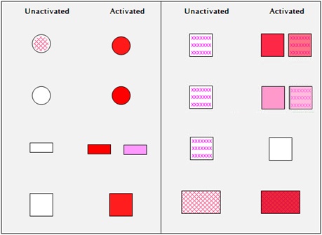

To identify if your device has water damage, check for:
  • corrosion, discoloration, or oxidation on the charging, headset, SIM or memory ports.
  • moisture under the display screen.
  • Liquid Detection Indicator (LDI) / Liquid Contact Indicator (LCI) is activated.
    TCL uses a white field with pink or red "X" marks to indicate a device that has had no liquid contact. When the indicator comes in contact with liquid, the "X" marks become pink or red smudge marks across the white field.
    The Liquid Damage Indicator (LDI) is located in the SIM card tray. Simply remove the tray to view the LDI.

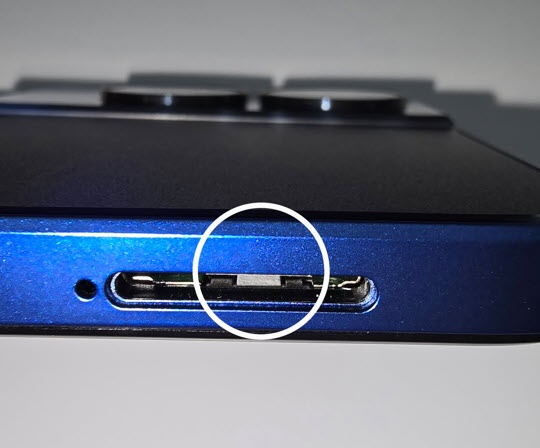

  • USB / Charging: Examples of charging port damage include but are not limited to:
    • port is loose or wiggles.
    • bent ports.
    • corrosion.
