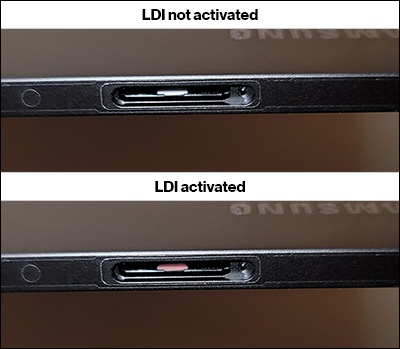

    • Liquid Detection Indicator (LDI) / Liquid Contact Indicator (LCI) activation.
      Samsung uses a white field to indicate a device that has had no liquid contact. When the indicator comes in contact with liquid, the paper becomes pink.
      The Liquid Damage Indicator (LDI) is located inside the SIM tray slot, directly to the left of the SIM pin hole. It's visible by looking inside the SIM tray with the ejection pin to the right while the tray is removed from the device.
      LDI
