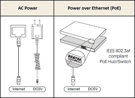

  5. Connect the base station to the power and network by selecting one of the following options:
    Contact your IT admin before selecting the power option.
    • AC Power
      Use the supplied power adapter (5V/2A). A third-party power adapter may damage the base station.
    • PoE (Power over Ethernet)
      Ensure the hub/switch is Power over Ethernet (PoE) compliant.
    Power and Ethernet connections
