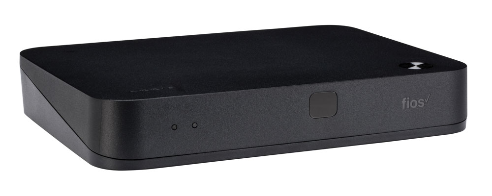

When this feature is activated on both your TV and your set-top box, they will work together to display video from the same device and prevent encounters of a "blank" screen, "no signal" or “no video” message appearing on your TV.
This feature may have already been activated on your Fios set-top box. You can check if the feature is activated on your set-top boxes, by pressing the MENU button on your Fios remote and then selecting Settings > Audio & Video > Video Settings > TV Input Control > Enable.
If a check mark (√) appears next to Enable, the feature is activated on that set-top box and you will have the option of activating it on all of your set-top boxes at that time. Next, you must take the following steps to activate the feature on each TV:
  1. Make sure your set-top box is connected to your TV with a HDMI cable
  2. Use the remote that came with your TV (not the Fios TV remote) to access the Settings menu on your TV
  3. Locate the TV input control HDMI-CEC feature.
    Note: This feature may use a different name depending on the manufacturer of your TV. Please visit their website for specific names or unique brand instructions.
  4. Enable or turn on the feature under Settings on your TV.
Once enabled, on both your set-top box and TV, your Fios remote will turn on the TV at the same time as the set-top box and ensure the video is displayed from your set-top box.
