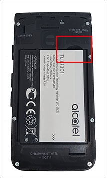

  3. Utilizing the notch, lift then remove the battery.
    Use notch to remove battery

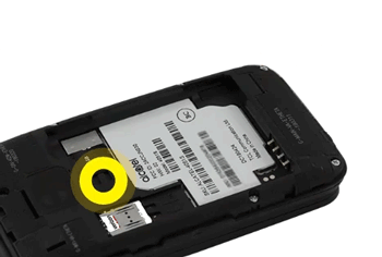

  4. Do one of the following:
    • Insert SD / memory card
      With the gold contacts facing down, insert the memory card. Once the card is fully inserted, the latch will automatically lift and hold it in place.
      If needed, press down on the latch to insert the card.
    • Remove SD / memory card
      Remove the SD / memory card by sliding it to the left. If necessary, press down on the latch to remove the SD / memory card.
