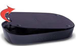

  2. Remove the battery cover.
    Utilizing the provided slot, carefully lift then detach the cover.
    Remove battery cover

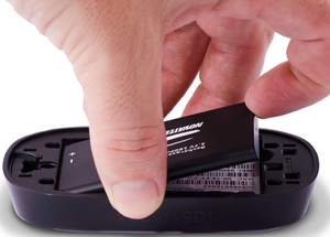

  3. Utilizing the notch, lift then remove the battery.
    Remove battery

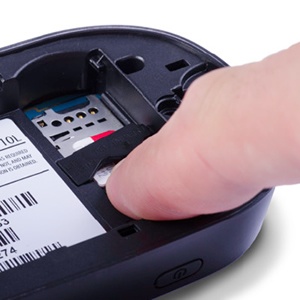

  5. Do one of the following:
    • Insert SIM card
      With the gold contacts facing down and the notch located in the upper-left, insert the SIM card as shown.
      Insert SIM card

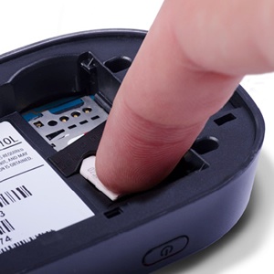

    • Remove SIM card
      If the SIM does not slide out easily, continue to hold the SIM hinge and push the SIM card from the top to dislodge.
      Remove SIM card
  6. Replace the SIM card hinge.
    Press down on the hinge to lock it into place.
  7. Insert the battery.
    Ensure that the connectors on the battery align with the connectors on the device.
  8. Replace the battery cover.
