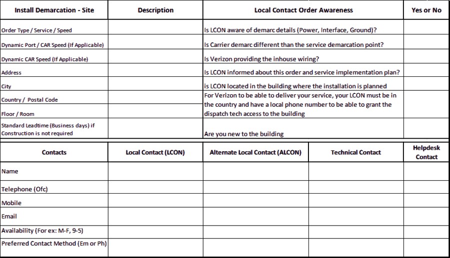

  • Local Contact Checkist
  •  If an authorization must be granted by the building owner, ensure you obtain this authorization ahead of time
     Ensure that all other specific security clearances are also obtained ahead of time
     If construction work is needed, approval from local authorities will be required
     Make sure you know where the technical room is located and that you have access
     Ensure internal cabling and room requirements are met
     If you are responsible for providing the OOB (Out Of Band) Modem/PSTN line, make sure it is available and you know the number
     Demarcation point needs to be identified early, exact location is required – floor, room/suite, cabinet, rack. If not available then it must be communicated as soon as possible
     If internal cabling is needed to create an extension between the demarcation point and the technical room, make sure it is ready before dispatch is sent
     At contract signature, provide valid local contact name, mobile number and e-mail
     If possible, provide an alternative local contact (in case the Primary is not reachable)
     Ensure that POC, or local contact is located on site, where service will be delivered
     Ensure that POC or local contact is aware of the coming installation
     If local contact is not usually based on site, ensure they are able to get there easily when required
     At the minimum, the person needs to be located in the same country as the site (he/she will be contacted by the carrier)
     Communicate initial timelines to him/her, as well as any update you may receive which may impact the site, the service or the project
     A Verizon Project Manager will provide a project plan for big projects, share this with the local contact
     Explain that his/her involvement is crucial to prepare the site for the coming installation and preparedness prevents delays and extra charges
     Encourage him/her to review Verizon requirements on this website and ask questions in case of doubt (this must be done as soon as possible)
     Check for any planned absence of the local contact over the coming weeks and ensure the backup contact is aware and reachable
     He/she will be able to provide access to the site, the technical room, and all other required areas
     He/she will be able to make decisions on installation and wiring
     He/she will answer our technical validation questions
     Download the checklist.

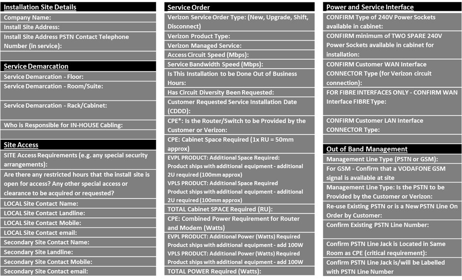

  • Order Verification Checklist (OVC)
  • Click on the image to download.
  • Technical Validation (TEV)
