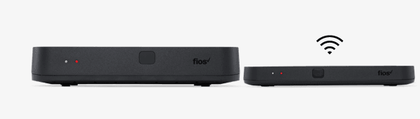

Fios TV One Set-Top Box
For activation details, watch How to set up your Fios TV One Set-Top Box, or review our Ethernet installation instructions, or our Coax installation instructions. You can also access instructions in Spanish here.
* If you have problems connecting your Fios TV One Mini to your Wi-Fi, use our Can’t Connect Troubleshooter.

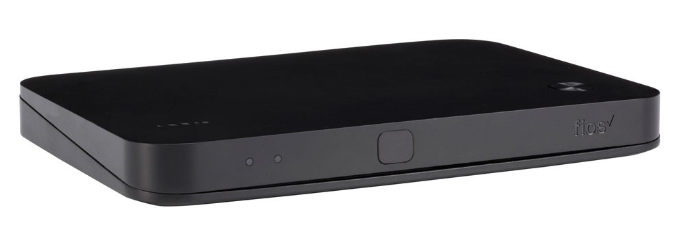

You can use the LEDs on the front of the Fios TV One and Fios One Mini to understand their status and to help you troubleshoot issues.
Fios TV One normal operation mode
- Power On Mode: Left LED is solid white. Right LED is off, unless it’s recording.
- Standby Mode: Left LED is dim solid white. Right LED is off, unless it’s recording.
- Remote Control Command Received: Left LED blinks white once.
- Remote Control pairing process: Left LED continuously blinks red while it’s pairing. Right LED is solid blue for about five seconds until it’s done pairing.
NOTE: While recording a show, the right LED will be a solid red color, generally independent of the left LED color.
Fios TV One service modes
- Booting up or auto-provisioning software: Left LED blinks white.
- Downloading software: Left LED blinks green. Right LED is off, unless recording.
Fios TV One error conditions
- Not connected to router, no IP address or re-initialization: Left LED is solid yellow.
- Waiting for timestamp or auto-provisioning error: Left LED blinks yellow.
- Non-recoverable error (unit needs to be replaced): Left LED is solid red. Right LED is solid red:
